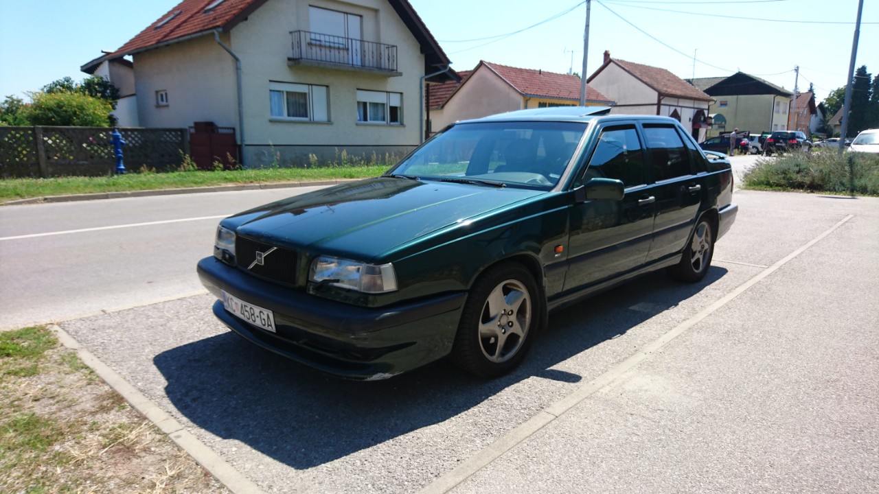

Slika prije kupnje:
shell gasoline station near me
